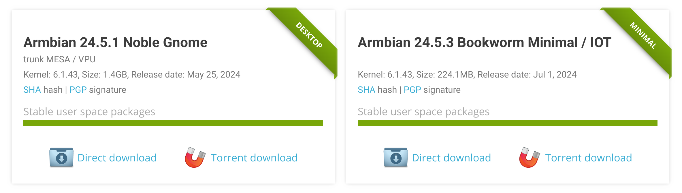

Recommended images¶
Recommended images on download pages are defined via regular expression mapping file https://github.com/armbian/os/blob/main/exposed.map (for changes sent PR to this file)

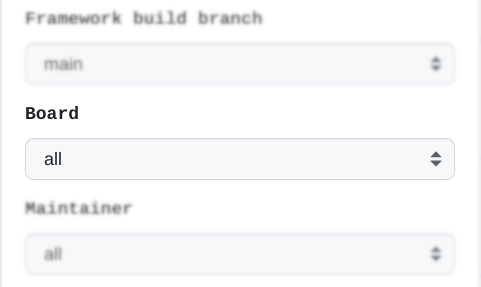

1. Open workflow and click¶
2. Select board¶
Bump version: Select if you want to trigger system wide version bump. Version override: Set version under which you want to release images.
Images versions are stored in JSON files: - https://github.com/armbian/os/blob/main/stable.json - https://github.com/armbian/os/blob/main/nightly.json
3. Run workflow¶

Generated images are uploaded to incoming folder https://rsync.armbian.com/incoming/ under your GitHub username and once they are confirmed working, please notify @igorpecovnik to move them to official download pages. Once images are moved to main download section, automation refreshes download pages index within 15-30 minutes.

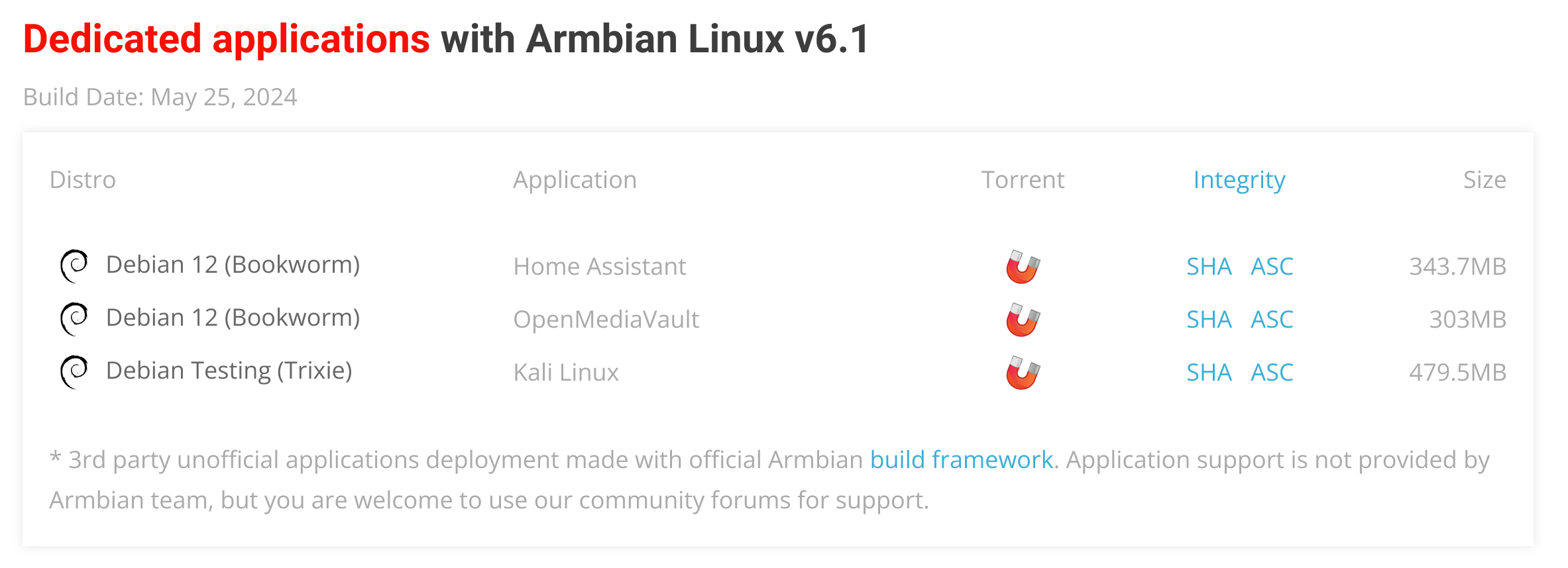

Prepare application images for release (release manager)¶
This build workflow is executed manually when making:
- a set of application images for specific device
- a set of application images for specific maintainer
- a full set of application images (default)

Generated images are hosted at GitHub https://github.com/armbian/distribution/releases and released at once. Automation refreshes download pages within 15-30 minutes after/if workflow finished succesfully.

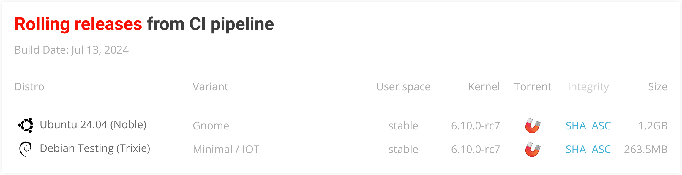

Build Rolling Release Images (cronjob)¶
Generates all nighly (Rolling Release) images defined in targets-release-nightly.yaml. This file is autogenerated from targets-release-nightly.template.
This build job runs every day at 9 a.m. UTC and can also be run manually when needed. Download pages are refreshed automatically after successful build.

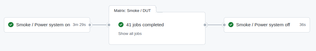

Smoke tests on hardware devices (release manager)¶
Smoke testing is preliminary testing to reveal simple failures severe enough to, for example, reject a prospective software release. Our test case is constructed of three steps:
- powering test equipment, consistent from several network switches, power supplies and dozens of hardware platforms
- running upgrade, reboot, repository switch, reboot, … tests in parallel
- uploading a test report as build artifact followed by powering the devices off.

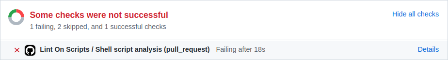

Lint on shell scripts (PR)¶
Run ShellCheck on changed shell scripts and report problems within. Linting runs automatically on pull requests.
