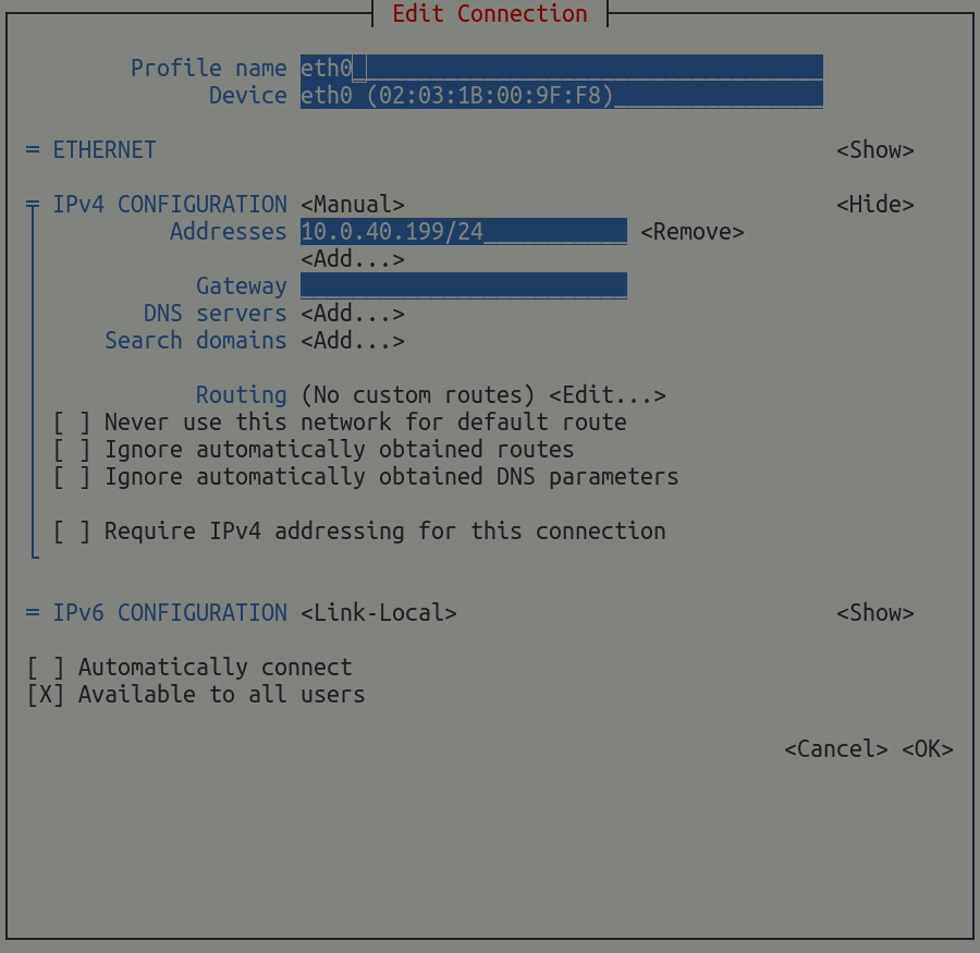

Alternatively, you can also use Network-Manager directly via the command line or GUI tools on your desktop:
| Bash | |
1 | |
Display screenshot
Replace eth0 with the name of your Ethernet Interface.

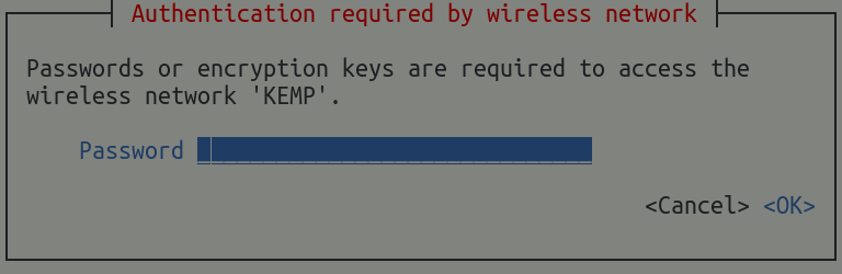

| Bash | |
1 | |
Display screenshot
Replace SSID with the name of your wireless network.
