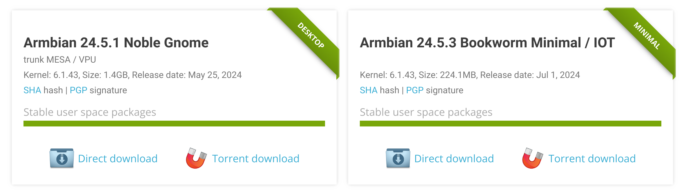

Recommended images¶
Recommended images on download pages are defined via regular expression mapping file exposed.map:

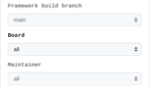

1. Open workflow and click¶
2. Select board¶
Bump version: Select if you want to trigger system wide version bump. Version override: Set version under which you want to release images.
Images versions are stored in JSON files: - https://github.com/armbian/os/blob/main/stable.json - https://github.com/armbian/os/blob/main/nightly.json
3. Run workflow¶
(Workflow takes around 15 minutes to complete. In case of network issues it can also take hours)
Generated images are uploaded to incoming folder https://rsync.armbian.com/incoming/ under your GitHub username and once they are confirmed working, please notify @igorpecovnik to move them to official download pages. Once images are moved to main download section, automation refreshes download pages index within 15-30 minutes.

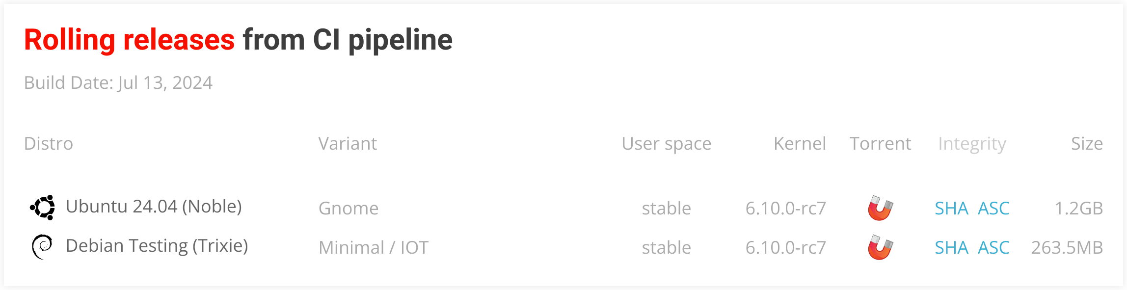

Build Rolling Release Images (cronjob)¶
Generates all nighly (Rolling Release) images defined in targets-release-nightly.yaml. This file is autogenerated from targets-release-nightly.template.
This build job runs every day at 9 a.m. UTC and can also be run manually when needed. Download pages are refreshed automatically after successful build.

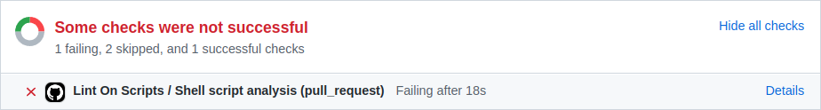

Lint on shell scripts (PR)¶
Run ShellCheck on changed shell scripts and report problems within. Linting runs automatically on pull requests.
