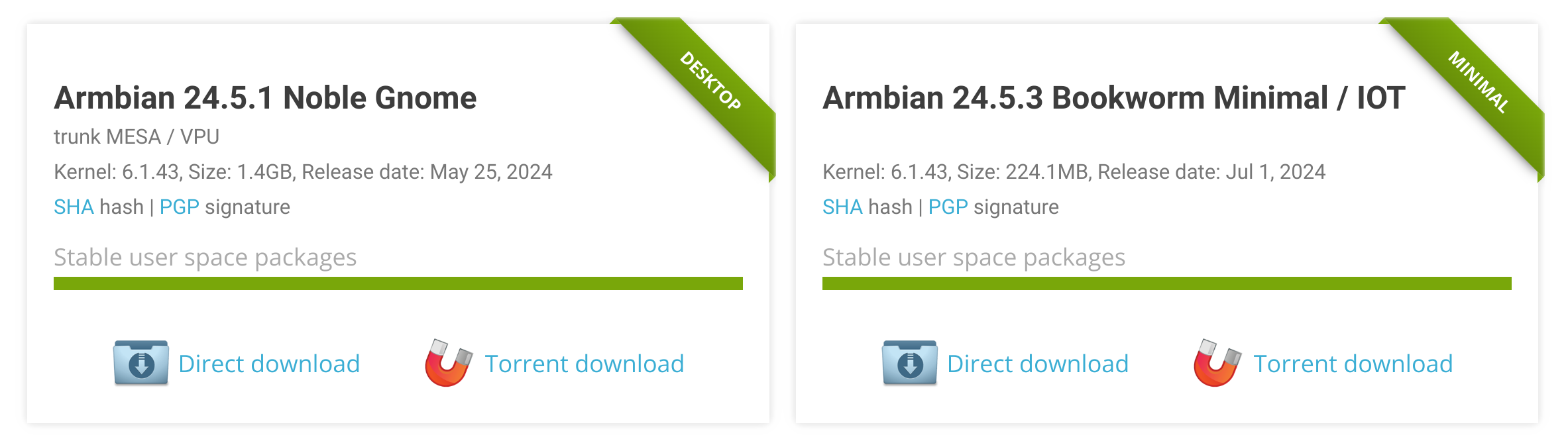

Prepare Standard Support images for release
Info
Manual executing permissions are tied to release manager role.
Build Standard Support Images
This build workflow is executed manually when making:
  • a set of images for specific device
  • a set of images for specific maintainer
  • a full set of stable release images (default)
Notes:
  • this process prepares images for release without pushing them to the download pages
  • you can only generate images that are defined in targets-release-standard-support.yaml build lists!
  • images generation workflows are compiled and are pretty much the same, just with different defaults
1. Open workflow and click
Run Workflow
2. Select board
Workflow
Bump version: Select if you want to trigger system wide version bump. Version override: Set version under which you want to release images.
Images versions are stored in JSON files: - https://github.com/armbian/os/blob/main/stable.json - https://github.com/armbian/os/blob/main/nightly.json
3. Run workflow
Build
(Workflow takes around 15 minutes to complete. In case of network issues it can also take hours)
Generated images are uploaded to incoming folder https://rsync.armbian.com/incoming/ under your GitHub username and once they are confirmed working, please notify @igorpecovnik to move them to official download pages. Once images are moved to main download section, automation refreshes download pages index within 15-30 minutes.

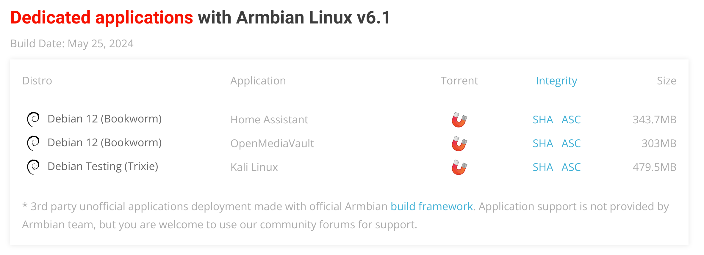

Prepare application images for release (release manager)
Build Dedicated Application Images
  • a set of application images for specific device
  • a set of application images for specific maintainer
  • a full set of application images (default)
Notes:
  • application images are released 10-15 minutes after build finishes succesfully
  • you can only generate images for applications that are defined in targets-release-apps.yaml build lists!
Run Workflow
2. Select board
Workflow
Version override: Use this feature if you want to keep them under the same version, but not lower then last released.
3. Run workflow
Build
Generated images are hosted at GitHub https://github.com/armbian/distribution/releases and released at once. Automation refreshes download pages within 15-30 minutes after/if workflow finished succesfully.

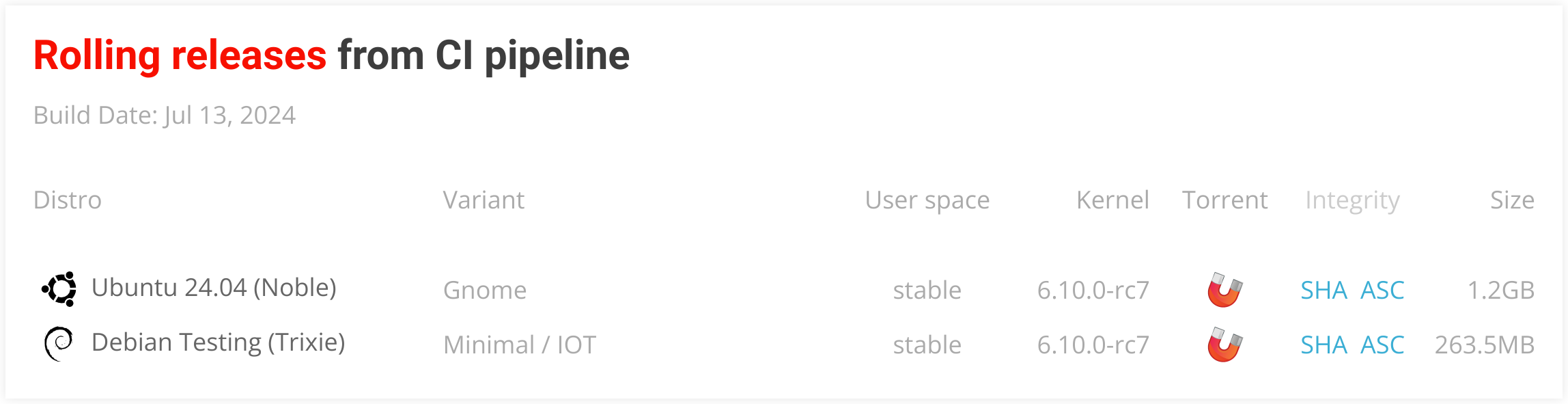

Build Rolling Release Images (cronjob)
Build Nightly Images
Generates all nighly (Rolling Release) images defined in targets-release-nightly.yaml. This file is autogenerated from targets-release-nightly.template.
This build job runs every day at 9 a.m. UTC and can also be run manually when needed. Download pages are refreshed automatically after successful build.

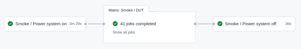

Smoke tests on hardware devices (release manager)
Smoke testing is preliminary testing to reveal simple failures severe enough to, for example, reject a prospective software release. Our test case is constructed of three steps:
Smoke
  • powering test equipment, consistent from several network switches, power supplies and dozens of hardware platforms
  • running upgrade, reboot, repository switch, reboot, … tests in parallel
  • uploading a test report as build artifact following by powering the devices off.

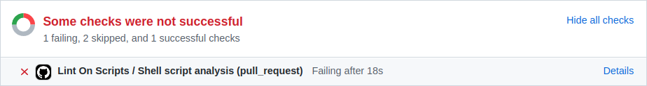

Lint on shell scripts (PR)
Lint On Shell Scripts
Lint
Run ShellCheck on changed shell scripts and report problems within. Linting runs automatically on pull requests.
